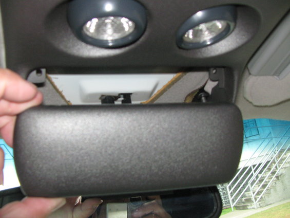

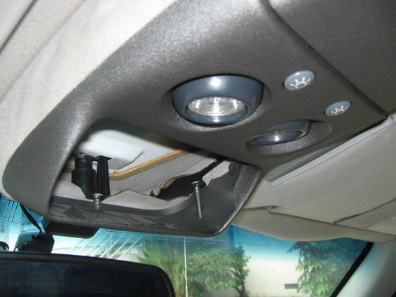

When ever we have a good rain I get water dripping in from behind this plate.
I took the face plate off to see how much water I might have sitting up there or moister damage. It looks ok.

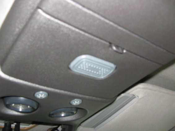

Whats this compartment for?

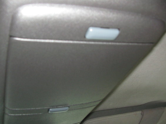

This one holds my glasses just perfectly.

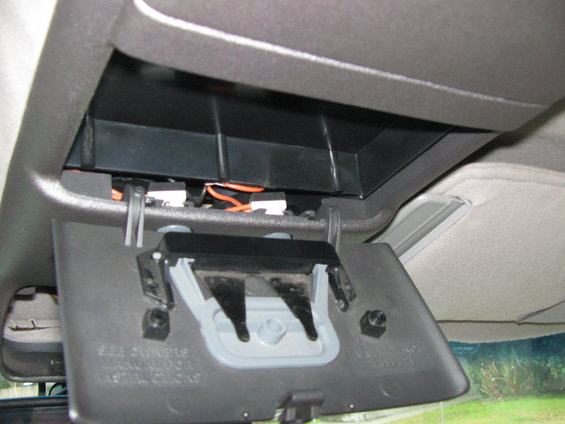

This last one seems strange as well?
This is as far as it opens.

The water is from your running lights on the roof. I took all mine off, then stuck each screw in some silicone to before I put the ligths back on. Have not leaked since.

yeah the rubber seal around the lights is letting water in, the compartments are
1. is for the garage door opener if you have one
2. is for sunglasses
3. is for cd and sorts, i have the same overhead in mine..

what about -01?
what is the face plate I removed there for instead of what factory put there?
I can see how the button would be for a garage door & I suppose I could see how chevy had made a bad design in a cd holder.

some had an opitional compass and outside temp there

was'nt that in the interior mirror?

yeah but some models had it in the console, so to save money they just made it optional and put solid plate there...

that plate is a good place for a guage and some switches.

the blank plate also was rear a/c controlls on tahoes and suburbans.

the 3rd spot makes for an awesome napkin holder for ppl who like to eat and drive.
